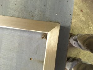

#3 29-02-2020 22:11:38
brano121
Registrovaný: 06-02-2018
Re: Povrchova uprava nerezovych profilov
http://www.svarforum.cz/forum/uploads/thumbs/8313_a9015f10-cd33-4046-a285-185694107aad.jpeg
zatial takto,ešte  bude treba doladit

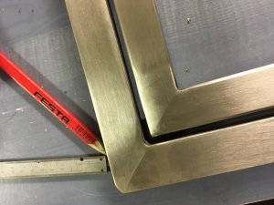

http://www.svarforum.cz/forum/uploads/thumbs/8313_840c7a90-dde9-4427-8a1b-9ea6754f6f8c.jpeg

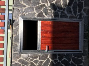

http://www.svarforum.cz/forum/uploads/thumbs/8313_339f0e1e-a6cf-4929-8e89-49bc6e9b1907.jpeg
