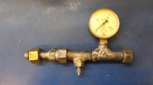

Re: argon
V zavitu problem neni ar prepoustim normalne do hasičakuhttp://www.svarforum.cz/forum/uploads/thumbs/2784_20140813_063417.jpg
