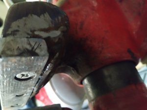

http://www.svarforum.cz/forum/uploads/thumbs/10486_img_20231220_175805.jpg[/url]
Vyvaril som kus ulomeny pod celustou na zveraku,ked som ho doniesol domov .Pouzil som esab 121.Zatial to drzi..Pre rypalov na vzhlad nehladiet. 😉
Editoval kimir (20-12-2023 18:43:52)
