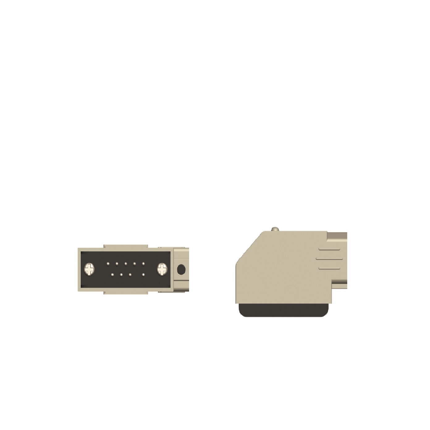

Re: Fronius Transsteel 2200
starsie ttg/ttw horaky ti pojdu, len ak si kupis redukciu "Kábel adaptéra Tuchel-TMC 0,2m" 43,0004,6037
https://www.schweiss-shop.de/fronius/ad … MP03122635
stare horaky mali hranaty sivy konektor (Tuchel), transsteel uz ma okruhly konektor (TMC)
https://www.weldingcentre.com/wp-content/uploads/2015/10/ERCP8.jpg
https://cdn.shopify.com/s/files/1/1567/3323/products/IMG_1972_1400x.jpg?v=1591093523
pripadne prerobit, alebo pozriet ttg horak rovno s konektorom TMC
https://www.rapidwelding.com/dynamic/Di … C035%2C989
ale ten asi na bazosi nekupis big_smile
